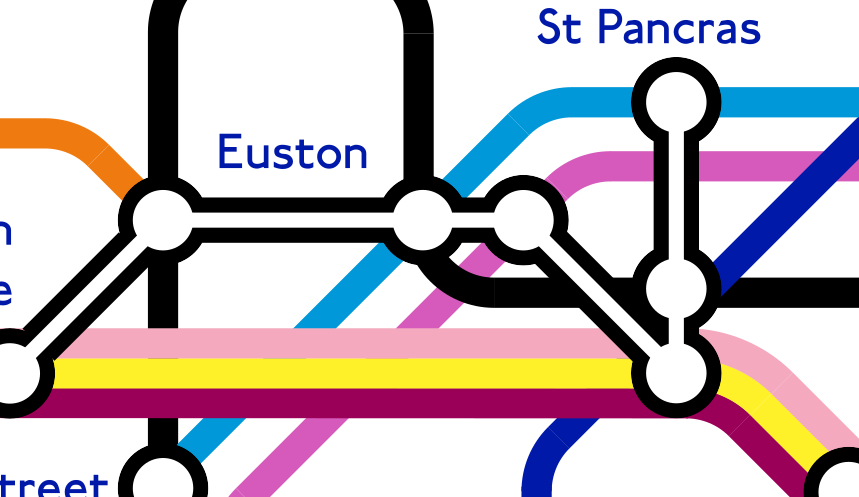

Strangely enough on the version shown at Londonist, Holland Park station appears to have disappeared! And indeed the Evening Standard one. Is this a versioning issue, perhaps?
Yes - it's all versioning. There are a few other small typos that made it into those versions as well. I'm just hoping as few people noticed as possible. ;)
A little niggle - Kings Cross St Pancras: lines should not change direction underneath a station blob. Can the Warren Street description not be moved to the left of its blob on a single line, bring Crossrail2 straight up and then bend parallel to the Victoria, stretch the Victoria blob northwards a bit to then fit in the Crossrail 2 bend?
Needless to say, getting that section right was a total nightmare - I tried about fifteen different versions before settling on this one, and there was a lot of discussion on another thread on this forum about it.
I've mocked up what your proposal might look like (hopefully this is what you had in mind):
The biggest problem is how now to connect the CR2 blob to King's Cross St Pancras. Linking it to the top KXSP blob as previously would break another rule - that lines shouldn't run under connector lines. Since the connector lines have to be at 45 degrees, linking the CR2 blob to the middle blob would mean dragging KXSP very far to the left (far enough left that the black outline of the CR2 blob overlaps the KXSP interchange line). Linking to the bottom blob creates even more overlapping black because of the presence of the Northern line.
I'd emphasise that the bend under Crossrail 2 under the Euston-King's-Cross-St-Pancras station blob isn't any more severe than the bend under the District/Circle lines at Paddington on the current standard tube map, so I'd be inclined to stick with the current version. But I don't think there will ever be unanimity on that! ;)

Thank you for having a go!
As a Mother Superior once said: "how do we solve a problem like Euston Kings Cross St Pancras?"
It looks like the whole area is going to need a redesign.
I might try fiddling about myself in Paint.

I think I've done it, working off the whole map, as it soon became obvious that more is going to have to move to accommodate XR2.
XR2 blob links diagonally down and right to KXSP Northern blob and vertically to Vic line, this shifts the Vic line left and so too the whole of Euston Northern/Vic and in turn the Northern all the way up to Belsize Park; Warren Street has to become a double blob, and everything south of that has to go left and/or down a bit; and XR2 to the west of KXSP has to go north a bit.
This is the rough outline as I got frustrated very quickly!
XR2 blob links diagonally down and right to KGSP Northern blob and vertically to Vic line, this shifts the Vic line left and so too the whole of Euston Northern/Vic and in turn the Northern all the way up to Belsize Park; Warren Street has to become a double blob, and everything south of that has to go left and/or down a bit; and XR2 to the west of KGSP has to go north a bit.
That's a great bit of innovation, but I'm bothered by Euston-KX CR2 station being closer to StP than StP Victoria Station. :/
I've had my own idea about that, I'll try to mock it up today.
I like this a lot! I think Warren Street being a double-blob isn't too bad either - keeping the Warren Street label a little further down avoids it being confused for the label for the Euston Square blob. The CR2 blob being placed well within KXStP is a bit of a white lie, but again it's not unusual for the tube map to do that kind of thing.
Compare, for example, the way the current tube map puts Paddington's Cirlce/H&C platforms between Bakerloo and Circle/District, when in actuality the only direct interchange is between Bakerloo and Circle/District:

Thanks!
XR2 ending up being well within KXSP has niggled me but I cannot really see any way of placing it equidistant between the two and keeping the design rules with the map as it stands - I do think that the whole thing is going to need a radical overhaul at some point - but considering that Farringdon Elizabeth line XR1 looks closer to Barbican...
And (another crude mock up alert!), shifting things around has allowed for a more direct routing of XR2 through central London.
