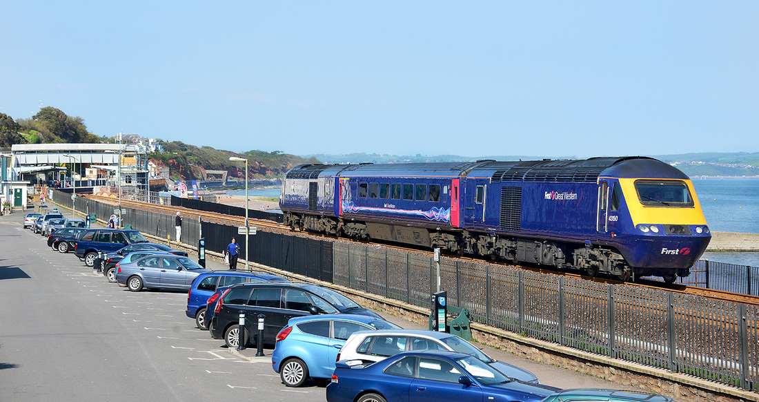

I see no logical reason why units cannot be designed so that they can be easily reformed with 2 driving cars and zero to many intermediate cars. The killer is the requirement for disabled toilets and wheelchair spaces which would take up a disproportionate amount of space in a short unit.
Hold on, that sounds familiar...
[Photo: FGW HST in "2+1" formation at Dawlish on an ECS move.]
