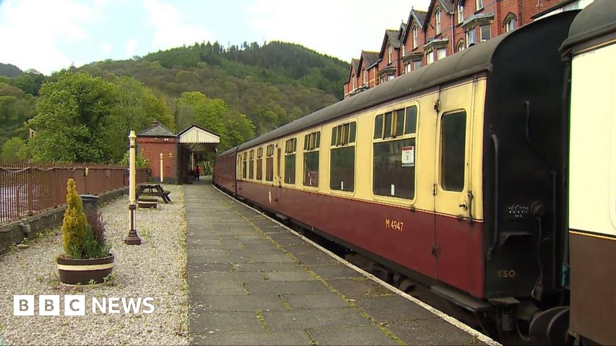

As I understand, the LLangollen Mk1's went for sums north of 35k plus auction fees and then transport on top. Mk2's will typically be cheaper as largely air braked so not as attractive to many pres railways.

Thank you very much, Bet they were happy with anything over their £20-£25K estimate though. I don’t want to sound stupid but does being Air braked affect preserved railways more please? Is it easy to tell which locomotives on a preserved line can work with either Air brake or dual brakes coaches please? Sorry to sound dumb

Preserved non mainline steam locos generally don't have anything other than a vacuum brake so air braked only stock is not of any interest to many preserved railways.

Mark 1 Coaches (particularly TSO = Tourist Second Class Open) are much valued by many heritage railways as they combine the look of a heritage carriage (slam doors) with the desirability of being high seating capacity and usually with tables in a 16 tables X 4 seats per table configuration. Whilst compartment stock has more heritage appeal to the customer (think Harry Potter) it has the disadvantage of being lower capacity overall and it is more difficult to encourage passengers to share a compartment. Though Mk1s are renowned for rotting at the waist rail.
One other point Heritage Railways consider is if the carriage is equipped for steam heating, electric heating or dual heated. A steam heated carriage uses steam from the steam loco. If a diesel is used then either the diesel loco has to have an auxiliary steam boiler or the carriage has to be fitted for electric heating.
If Heritage Railways get into the realms of air braked stock then the complexities multiply.
Some heritage railways have acquired considerable amounts of rolling stock over the years and are faced with the dilemma of what to do with it all bearing in mind they may only have the resources to maintain a proportion of the stock. Hence you occasionally see adverts by HRs seeking to dispose of "non core" stock.
Carriages left in the open out of use even if sheeted over do deteriorate at quite a rate of knots. It can be quite a dilemma not wanting to dispose of heritage stock but equally not having the resources to maintain it or even store it in such a way that deterioration is minimised.
