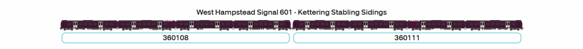

Just looking on RealTimeTrains to see what movement & action is coming through, I see that there is the usual empty coaching stock being transported.
Which then i was left puzzled by a West Hampstead signal just outside Bedford...... Now Hampstead is like a few miles away. the other side of Luton.
Do services really get held back by other trains that far away.

In short yes, for pathing reasons, last night my empty stock was due to be held at T1728 just outside Reading for a few mins awaiting a platform but in reality I was 30 early so didn’t have to

The signal you are talking about is just outside of Bedford depot, but is controlled by West Hampstead

But to expalin a little, WH601 signal is controlled from West Hampstead, but located on the Up Slow line, south of Bedford and just south of the entrance / exit of Bedford Cauldwell Walk ‘depot’. It is a ‘shunt’ signal and allows a train to head northbound on the Up Slow Line, which is usually used southbound. A train so signalled ca be routed into Cauldwell Walk, or along the Up Slow to WH467 signal, and thence into Bedford station (either Platfrom 1 or 2).
Because trains often reverse just south of WH601, either coming out of, or into the depot, it is a formal ‘timing point’ in the timetable.
