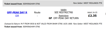

The attached image is a screenshot from BRFares.com,
which lists all fares and restrictions.
You will see that the restriction (code GF albeit not shown) is only FROM "Birmingham Stations" (which for this purpose is New St) in the afternoon, so more confirmation that the ticket was valid.
Attachments shows the off peak ticket price of £2.35 with railcard, and the following restriction:-
Outward & Return:​
M-F FROM 0930 & NOT VALID FROM BHAM STNS 1635-1800​
Ticket issued from:​
BIRMINGHAM STNS​
Fare Setter: WEST MIDLANDS PTE​

Having had a look at that restriction code myself, I think the longer worded part might be interpreted as not allowing train departures from the listed stations, in any direction , in the evening peak. As most trains from UNI towards BHM stop (and depart again) at Five Ways (which is on the list) they might be caught in the restriction. That begs the question of how limited stop trains might be covered, or not. I'll try to capture a screen shot of the full wording.

It's in the Northern guide for revenue staff to issue Penalty Fares in these circumstances, so maybe it's in WMT's as well. Several other companies routinely did this for years. It's unlikely that the inspector will be considered to have made a mistake, they were likely to be following the process set out for them by their manager.
Johnny3894
14 Jul 2025
5
Hi, I've written and amended a draft of appeal with the help of chatgpt, hopefully I've put all the points that everyone mentioned, and I'll attach the screenshots and my tickets when I'm actually submitting the appeal form on the website.
1. My ticket was valid for the service I used I held an Off-Peak Return ticket, which is subject to Restriction Code GF. According to the wording of Restriction Code GF (available at www.nre.co.uk/GF, as printed on the ticket itself), the evening peak restriction applies only to departures from Birmingham between 16:34 and 18:01. It does not apply to arrivals into Birmingham during this time, which was the direction of my travel. Additionally, I include a screenshot taken from both Trainpal, which is an authorised ticket seller and where I purchased this exact ticket, and West Midlands Train's website, with the same train is still shown as available at the Off-Peak fare when searching return journeys involving the same trains. Under Regulation 4(1) of the Penalty Fares Regulations, I produced a valid ticket for my journey. Therefore, the Penalty Fare should not have been issued.
2. The Penalty Fare Notice did not include a valid reason The Penalty Fare Notice states the reason as simply "Other" , without any explanation. Under Regulation 5(2)(b) of the Penalty Fares Regulations, the notice must include an explanation of why the person is being charged a penalty fare at the time of issue. This requirement was not met. If West Midlands Trains claim that a verbal explanation was provided, I would refer to Regulation 16(4), which states that the burden of proof is on the operator to demonstrate that the regulation was complied with.
3. Even if a restriction applied, a Penalty Fare is not permitted Even if it were incorrectly considered that my Off-Peak ticket was not valid at that time, this would not mean that I failed to produce a valid ticket. Under Condition 9.5.1 of the National Rail Conditions of Travel (NRCoT), if a passenger is found to be travelling with a ticket that is not valid for the time of travel, they are liable to pay the difference to the cheapest valid fare, not a Penalty Fare. The Conditions do not allow train operators to issue Penalty Fares in such cases. Therefore, again, I satisfied the requirement to produce a valid ticket under Regulation 4(1), and there were no lawful grounds to issue a Penalty Fare.
Watershed
26 Sep 2020
16,816
That sounds good. I would remove the reference to a potential a verbal explanation of the reason for issue - a verbal explanation would not be compliant anyway, as it has to be written. Regulation 5(2) refers:
the collector must provide that person with the following information in writing at the time the penalty fare is charged
So you can just remove the world "verbal" and make that sentence say "If West Midlands Trains claim that an verbal explanation was provided, I would refer to Regulation 16(4)...."
I would also include the point I made in my last paragraph about Regulation 16(3)(a). You could copy that whole paragraph as it stands, just replacing "your" with "my" in the last sentence: "Accordingly, the appeal panel is obliged to allow my your appeal."
Johnny3894
14 Jul 2025
5
Thanks for the advice. I've submitted the final version of the appeal. I'll update this thread when I've received results of the final appeal, and hopefully it'll be a good one.
