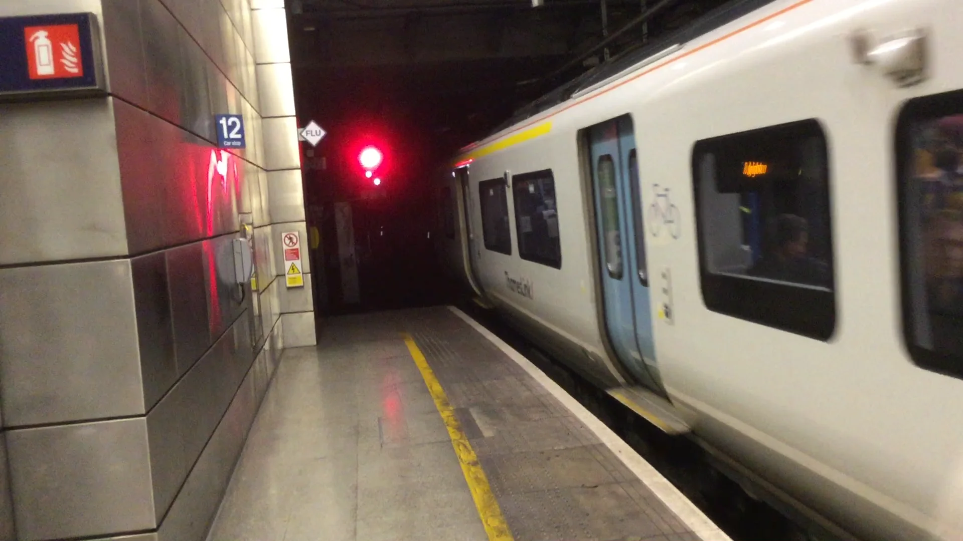

Platform A at St Pancras low level example of POSA working
18,515
Northampton
Really? Neither Gatwick or the ELL are mentioned as PoSA areas in the Sectional Appendix.
(correcting my earlier AFIAK post: ) Sectional Appendix only lists PoSA in the Table A from Kentish Town to just north of Elephant and Castle, Blackfriars to Metropolitan Junction, Waterloo East to New Cross, London Bridge to New Cross Gate, and the Canal Tunnels.
