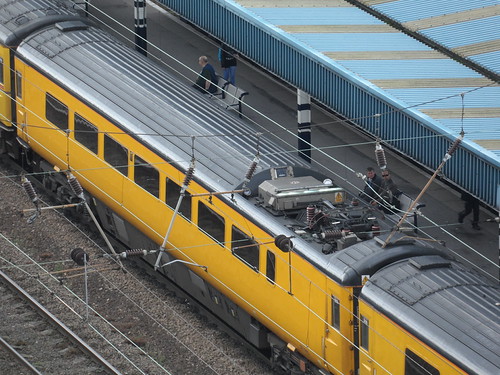

There is a pantograph on the NMT. It isn't used, it has never drawn current. I think it was there to help measure the "stagger" on the OHLE and the wire wear. Pics:
Doncaster by DarloRich2009, on Flickr
Derby by DarloRich2009, on Flickr

I'm afraid as outlined above, the is is now as was. Pantograph has since been removed, as seen here last year.
DarloRich
32,962
Fenny Stratford
ok. thanks for the clarification - i didn't know it had been taken out. I haven't seen it for a while

I saw it while out on my daily exercise on the 29th April and for those wondering, that's its current format/look.
