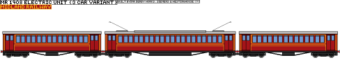

I did some research and found some strange drawings of three-car trainsets with pantographs similar to those on the LB&SCR South London Stock units. But now the question arises whether such a unit actually existed or is it just a concept?
Nie wiem do końca czy tak on wyglądał, ale narysowałem tą tajemniczą jednostkę.
"I don't know exactly if this is what it looked like, but I drew this mysterious unit" (Sorry I accidentally wrote it in Polish.).
The window layout of the motor car corresponds to the photo, except that the doors appear to have a single window not a double - but interestingly the same discrepancy applies to the Rue d-Etropal model - possibly they were altered at some stage?

Of the original 3 motor coaches, two had Siemens electric equipment, each with two bow collectors, the other Westinghouse equipment with a (diamond) pantograph. I don't know whether they (and the trailers) could all work in multiple together, or whether the two types of equipment had to be kept seperate, either initially or later.
