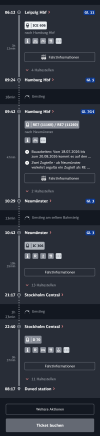

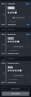

Hello, I need some help or ideas for the now changed situation on my interrail trip.
This trip was due to start on 11th August, leaving Leipzig on the first ICE (ICE 606) to Hamburg HBF where there would have been a 27 minute connection to Snalltaget IC306 to Stockholm and again well over 1 1/2h to change to SJ Sleeper D70 to Jämtland for a hike.
I have reservations for both the IC306 as well as Sleeper train D70 as well as some onward transport form the final station.
However, this connection has just become more perilous. Due to track works IC306 will now start from Pinneberg instead of Hamburg HBF which will be impossibe for me to reach that day.
There is a possible connection that has an 18 minute change in Hamburg HBF on to RE7 arriving in Neumünster with 13 minutes to spare to get onto IC306, which would be due on the same platform for this.
If this changed is missed I will arrive to my final destination in Jämtland half a day late and would also miss some onward bus transport to a trailhead which is only available in connection with train D70.
The reservation for the sleeper would also be moot and other reservations to get to Stockholm and beyond would potentially be needed.
I have attached screenshots of both connections (old and new) below.
