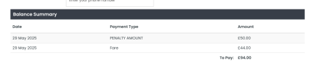

I sent a photo of the Manningtree to Camden ticket of my first appeal, but I don't have that ticket anymore.
Thanks for the advise, when I go on to pay they are saying I still need to pay the fare as well, which I have already paid? Surely this can't be right?
I'm afraid the amount is correct. A Penalty Fare is £100 plus the appropriate fare, reduced to £50 plus the appropriate fare if paid within 21-days (the clock stops on the 21-days while an appeal is being considered)
Although you'd paid for a ticket because it hadn't been printed out you're treated as though you didn't have a ticket.
29,441
It is correct - they are entitled to ask for the fare part, too. That is part of the penalty fare.
