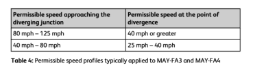

See attached
For example, from page 74
Because flashing aspect sequences are generally applied to diverging signal routes with high permissible speed limits, the likelihood of a train exceeding the permissible speed limit would increase if the junction turnout speed is less than train drivers expect. Table 4 sets out permissible speed limit criteria typically applied to control this.
  • Signalling Layout and Signal Aspect Sequence Requirements.pdf

The rules changed over time, generally to make flashing aspects more applicable than they used to be. Cheadle Hulme was 45mph diverging / 100mph straight, and remained MAR initially. It’s now MAY-FA4 even though the speed limits are unchanged. The version I posted above is relatively recent but may not be the most recent.

They are for the opposite purpose, they are to inform the driver that the diverging route is set and clear, so the driver only needs to moderate the train’s speed appropriate to the diverging route speed. Without them, the train’s approach speed would be slower, regulated by adverse signal aspects.
Previously, for example, MAR would cause the train to be regulated almost to a stand by a red aspect in advance of the junction.
My example of Cheadle Hulme, for example (up direction with diverging route set towards Macclesfield), meant that trains almost came to a stand on the viaduct, when the signal would clear and the train would re-accelerate to 45mph for the diverging junction. Now it only has to slow down to 45mph from line speed by the time it reaches the junction.
Multiple diverging routes - only the highest speed diverging route gets flashing yellows. Drivers know which route this is and moderate the train’s speed accordingly.

A couple of additional points.
If there are multiple diverting routes at the junction or junctions ahead of a junction signal, the flashing aspect sequence normally only applies to one diverting route.
Hence:
  • "Straight on" or highest speed route - no junction or route indication, normal aspect sequence.
  • Highest speed diverging route, junction signal shows a single yellow with junction indicator and flashing aspect sequence leading up to it.
  • All other diverging routes - approach release / approach control from red.
Note that the flashing aspect system is optional, it may not have been provided at a particular signal. With relay based interlocking, it is considerably more expensive. It is also relatively new in signalling terms, so will only feature on older signalling schemes if money was found to add it afterwards. Where not provided, the signal is approach released / approach controlled for all diverging routes. If any of the flashing aspect signals fail to flash, the system drops out of flashing aspect mode and the junction signal goes to red and operates in the approach release / approach control mode.
With a flashing yellow approach, the junction signal can be permitted to step up from a single yellow to a less restrictive aspect once the train has passed a certain point on approach to the junction signal. So if the line is clear ahead, it may step up to a green.
Similarly, a signal that is approach controlled / approach released will step up to the aspect that is appropriate for the diverging line and how far the line is clear ahead. When it steps up is determined by the train passing a certain point. In addition, there may be a time delay before the aspect changes. The length of the time delay may vary depending on which route has been set and the junction speed for that route. Lower speed routes having a longer time delay.
The train reaching the certain point may be detected by track circuits, axle counters or treadles (in combination with a track circuit).
The objective being to slow the train down to a suitable speed for the junction. However, due to the difference in performance of train braking systems, it is always a crude compromise on mixed traffic lines.
Where a time delay is also used, when the signal steps up then depends on the speed of the train.
